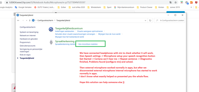

I'd like to share you my sudden solution...
We have connected headphones with mic to check whether it will work, then Speech settings -> Microphone setup your speech recognition button Get Started -> Cortana can't hear me -> Repeat sentence -> Diagnostics finished, Problems found (configure mic) and solved.
Then external microphone worked normally in apps, but after we disconnected external microphone internal microphone has started to work normally in apps.
I don't know what exactly helped so presented you the whole flow.
Hope this solution can halp someone else ))
yes.... it seems to work indeed!!!!
First, I tried via your way, but I could not click 'get started' at microphone.
Then I tried the same via the configuration screen; set a microphone.
I don't understand why, but now it works.
I can image it will happen again, it worked before a some rare moments, but hopefully with this method I can fix it every time!!!
many thanks all for your help!!
