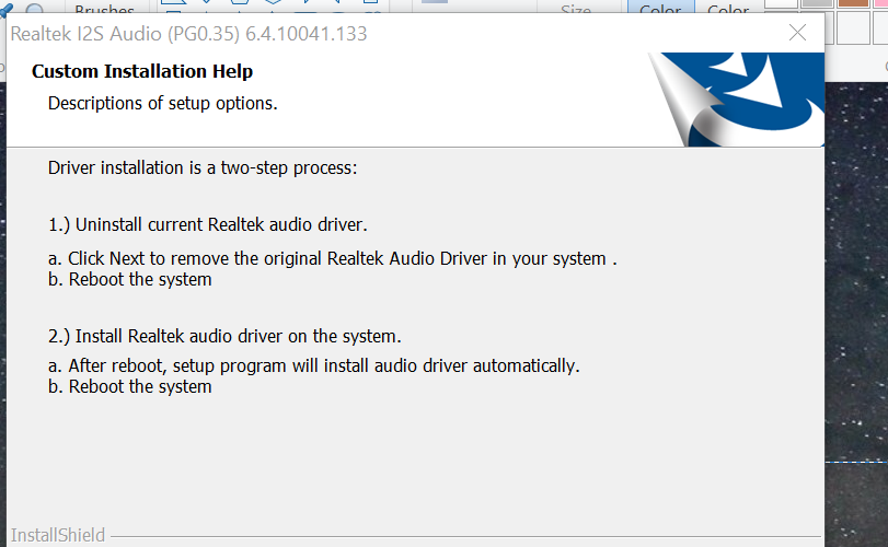

Thank you! I tried your steps, and I think I might be able to fix the problem, but I need a little more help. I tried the "run as administrator" and install of the Realtek device, and when I restarted, my mute button is no longer stuck "on" (the light is off), but my volume still does the same thing when I use f10 volume up - it will go up and work as long as I'm holding the button, but slide right back down when I let go.
When I initially started up the computer, it looked like this
saying "no audio output device is installed", and then it prompted me to install the Realtek device (though I'd already done that)
I tried that (installing again and restarting) but the same thing happened - no audio device installed, the prompt to install the Realtek device again.
This time I hit "cancel" because it wasn't seeming to work, and now it looks again like it did before - volume slider in the upper left-hand corner, X on the volume in the bottom menu bar. However, my mute button is no longer lit up. (see red circles in screenshot below)
Thank you so much for the help!
Update: tried installing the Realtek device again, and upon restart I got this message
And then the same installation prompt that I got the first time - it says it completes the first two steps (the uninstallation), and then upon restart it thinks it still has to uninstall, rather than automatically starting the audio install. I'm guessing this is user error somewhere along the way, but I'm not sure where I went wrong.
