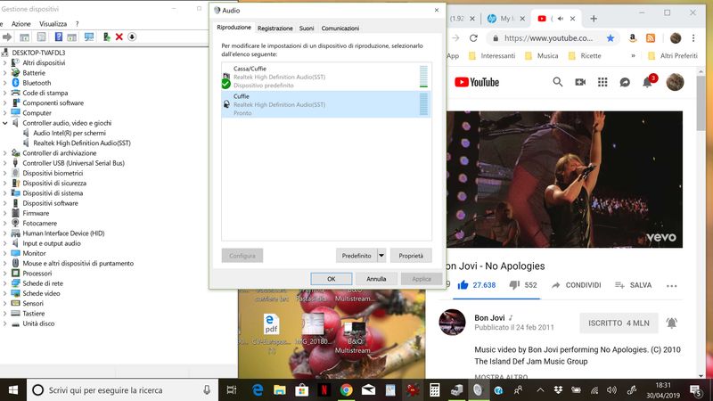

In the meantime, I tweaked here and there on my laptop and finally B&O audio control reappeared (don't ask me how!).
I don't recall which were the settings before my yesterday's audio issue but now this is my situation: if Multistreaming is turned off I can bearly hear audio with headphones and, unplugging them, sometimes I may hear audio directly from PC speakers (only for a few seconds).
If Multistreaming is on, I have two choices: Internal Speakers or Headphones. When I choose Internal Speakers, I hear audio from the pc speakers and, vice versa, if I choose Headphones, I  hear audio from them.
Can someone please check if these settings are correct? Thank you!
a) B&O Multistreaming OFF
b) B&O Multistreaming ON + PC SPEAKERS
c) B&O Multistreaming ON + Headphones

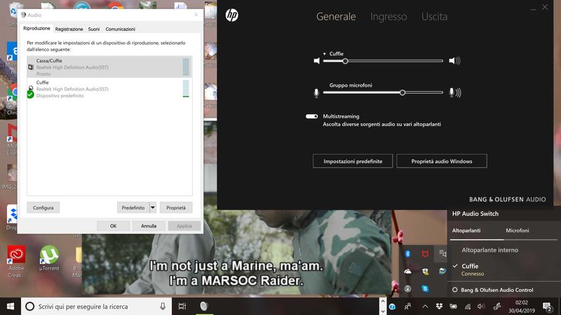

Ciao A4Apollo!
Thank you for helping me out with this audio issue on my HP Spectre x360 Convertible 13-ae0xx - 2PL61EA#ABZ.
I tried to follow all your suggestions but I had no success... I turned out having only headphones and no internal speakers.
So I reconfigured as last night. Now I have both speakers, internal and headphones, with these characteristics:
  1. I can hear audio through internal speakers only if B&O Audio Control  is set on Multistreaming
  2. I can switch from internal speakers to headphones or vice versa only through HP Audio Switch and not simply by plugging or unplugging my headphones from pc
  3. If I change the Realtek High-Definition (HD) Audio driver with the High Definition Audio Device driver, as you suggested, I loose my internal speakers and have only headphones as a choice moreover B&A Audio Control disappears
Any suggestions?
Grazie again for your patience

Ciao A4Apollo!
Grazie for your quick reply.
I have done all downloads and checks you have suggested but my issue has not yet resolved itself.
I believe there must be a bad configuration or some kind of conflict somewhere.
Today I'll check settings on another laptop and try to see if it's only a configuration issue.
What I still don't get are three questions:
  1.  Could it be that B&A Audio Control overwrites windows 10 settings? Is there a way to disable temporary B&A Audio Control? Last night after several tries I was able to hear audio through laptop speakers keeping Multistreaming off but then, for a cross check test, I ticked the "set to default" button in the B&A Audio Control and again I couldn't hear pc speakers without setting again Multistreaming on.
  2. Why is it that my headset speaker always turns out to be the default one when I have set the Internal Speakers as the default one? What is changing my settings?
  3. Why, when hearing audio from the laptop speakers and then plugging in the headphones, audio continues through laptop speakers and doesn't automatically go to headphones (the only way to achieve this is to manually switch internal speaker to headset with HP AUDIO SWITCH or with WINDOWS AUDIO SETTINGS (right-click sound on notification bar and select Audio Settings)
Any other suggestions?
I would love to click the Accept as Solution button in the post but still haven't solved the audio problem.
A presto, dina
