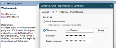

I am having an issue with the Windows 11 Audio like the below screenshots:
The Windows Audio service cannot be started and keeps on crashing with the below events logged:

Had kind of the same issue. found out that their was some kind of authentication issue. Try the following:
open services with admin
go to "windows audio"
choose properties and select the second tab "login"
Mine had some kind of service account.
changed it to local systemaccount and the service kept working
This didn't work for me. The service started after changing the login to local system account, but the speaker are still mute even I change the volume to maximum level. This concerns also wired headphones, bluetooth headphones and other audio devices I connected. All are muted even with volume level on max.
