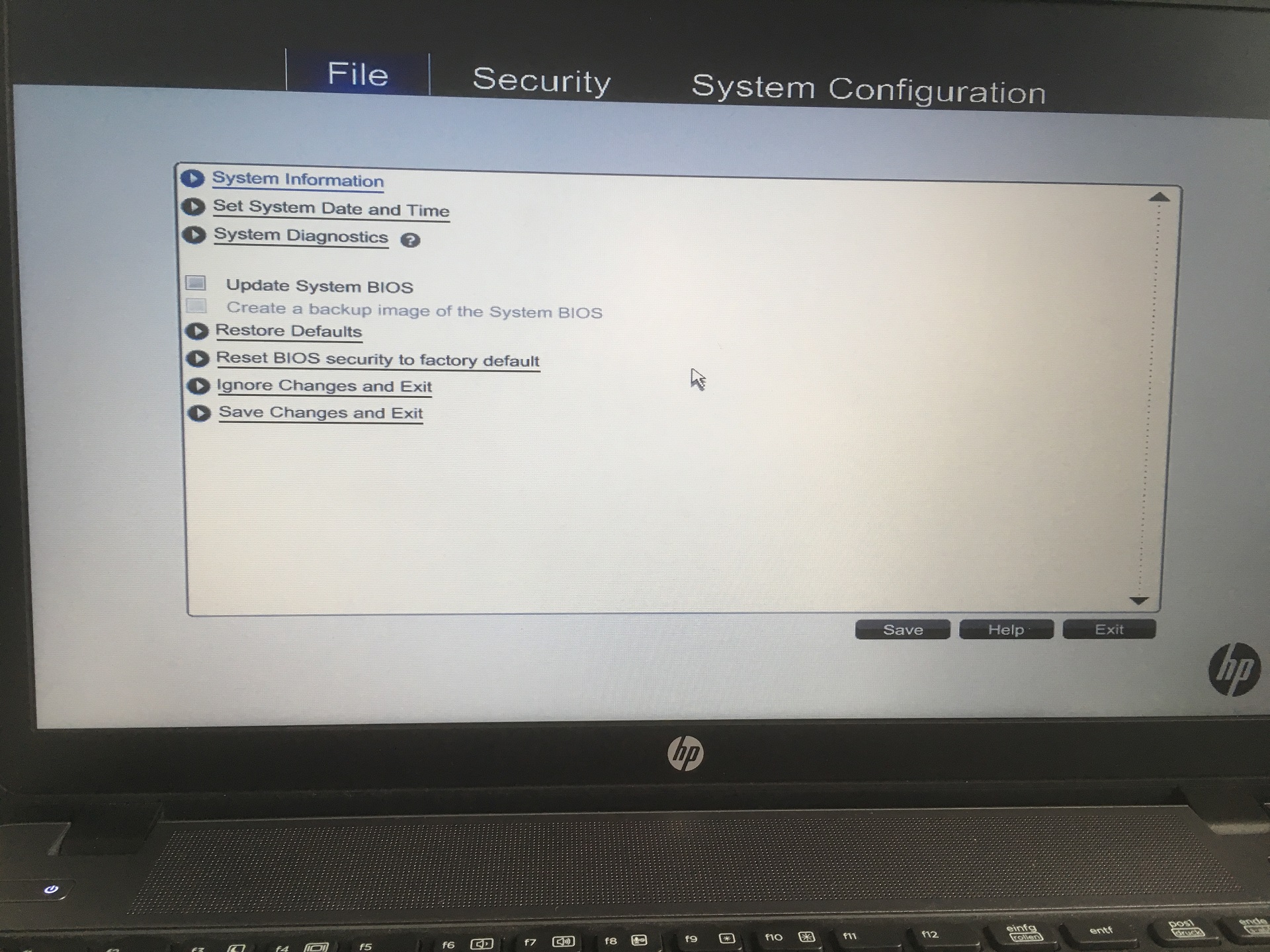

I press the right keys as you mentioned but nothing has changed.
Then i rename the File (the original File was 8 to 10 numbers with smb.bin) to the Serialnumber.SMB.bin. >nothing has happened
Then i used a smaller USB-Stick (from 32GB  to 4GB)>nothing has happened
Then i rename the File to SMB.bin>nothing has happened
The i delete the other Data on the Stick, so there was only the SMB File>nothing has happened
Then i realized the smaller USB-Stick was formated with NTFS instead of FAT32, so changed that and>IT WORKS.
Thanks a lot, Sir. I really appreciate it.
