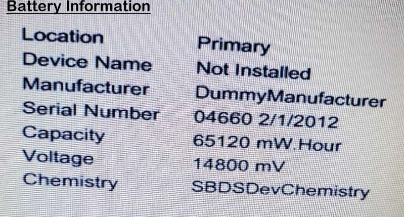

  • Check Battery status in BIOS - does not recognize battery as being installed (see attached)
  • Run HP Diagnostic tool (not recognize battery being installed)
And BEFORE installing the replacement battery, I did update the BIOS.  The current version installed according to the HP diagnostic I ran is version F.05 from 8/13/2015.   I have done nothing to the BIOS since replacing the battery.
Since the new battery replacement was installed, the laptop does boot up.  If the battery were completely faulty or entirely incompatible, the laptop likely wouldn't boot at all. So the HP Stream x360 does boot with the new battery, but the system doesn't recognize it.
Hey there! Thanks for the detailed update.
Even though you've replaced the battery with the exact PSO3XL Notebook Battery, sometimes non-HP replacement batteries can cause compatibility issues, especially if the firmware is slightly off. If you can, try getting an HP-branded replacement battery. HP batteries are often better supported by the system’s firmware and drivers, which could help resolve the issue.
The “CMOS Reset (502)” error typically points to an issue with the BIOS settings, often because of a bad or missing battery. Since you've replaced the battery and the system is booting now, it’s possible that the BIOS settings were reset when the old battery failed. Reinstalling the BIOS could be worth trying, especially since you've updated it before the battery replacement.
