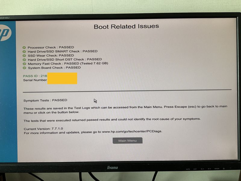

I've purchased a USB C to HDMI adapter, and managed to see what is happening during boot, using an external monitor.
What seems to happen is that the HP logo appears, then a brief white circle spin, which doesn't complete, then a freeze, then the external monitor says no signal detected. However, this is progress, as we have got past black screen, and I have managed to get to Diagnostics, and run the test - see attached.
I then managed to get to Recovery options - tried Start-up Repair - didn't work.

Since all the diagnostics come back as passed, that is a good start.
I might ask about the restore point, however.  The date is 09/05/22 - assuming that was before the problem started?
Also assuming since you are in UK that is May 9, 2022.
It would seem the driver for the display or the display has failed, since you are getting an external to work.

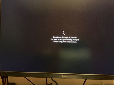

Getting deeper and deeper into this, all using external monitor, by the way. Still nothing on the inbuilt display.
Thank you for continued thoughts, TheOldMan
I am getting a repeated failure on updating the Intel High-Definition (HD) Graphics Driver, see photo.IMG_2062.JPG
Also Windows Update attempted some updates, ran into an error!
On restart, again external monitor, various update errors, see photo
After that,  Windows Update is trying to do Cumulative Update KB5013943 - waiting to see what happens.
