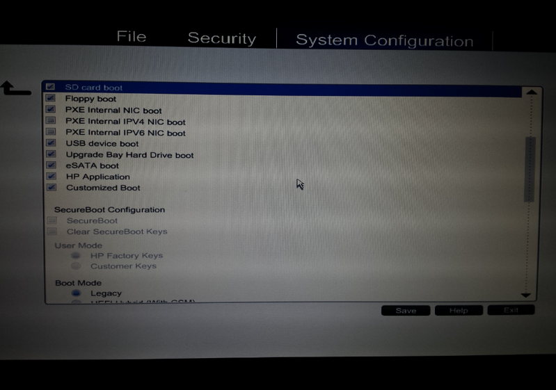

04-29-2018 01:43 AM - edited 04-29-2018 01:43 AM
Interesting. Thanks for all of the screenshots.
The BIOS in your notebook has more options than most.
Try a different brand SD card if you just don't want to go the route that most of us do. There is still no guarantee that the result would be any different.
There is a reason that virtually everyone else uses USB flashdrives for this purpose. They work!
I am trying to help you get the install done as efficiently as possible. I am familiar with the limitations of SD cards.
That is why I highly recommend that to avoid the negative result that you continue to have, you should swtch to either USB flash media or (DVD) Rewritable media. Both types are tried and trusted installer media.
You have found through personal experience and research that SD media cards are not a good choice for bootable media no matter what the BIOS states. I suggest that you consider it a learning experience.
