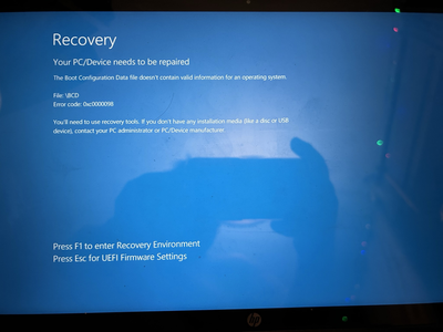

Hi    I've taken a day or so to try your suggested fixes an although the laptop does not have the option for extensive tests, i have run all the test options it has several times, including the CPU load test at 30 mins in length a couple of times.
i have tried the cloud restore key a couple of times aswell and it keeps failing at this screen,
if i try other options to try and boot the machine i also get
Trying to install HP Cloud Recovery or Windows 11 Install media just doesnt work
In Hopes that it is a problem with the BCD ive tried to follow the instructions on this site for a BCD repair using the command prompt.    but commands like
bootrec /fixboot     fails as access denied
and
bootrec /rebuilldbcd
claims the total identified windows installations = 0 Zero
and it doesnt help to fix the boot failings and it doesnt allow a successful install from the cloud recovery software pack
or from the Windows 11 Install media
please Advise
