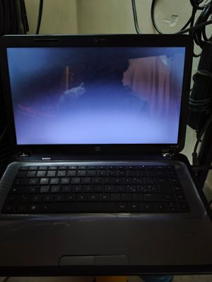

I tried to boot it and it won't get past this screen, i can't even open the start-up menu with ESC

Hi, i found out what was causing the issue, few days ago i replaced the CPU and probably i didn't connect correctly the monitor cable, i pressed where the connector is located and that fixed the issue, LOL
