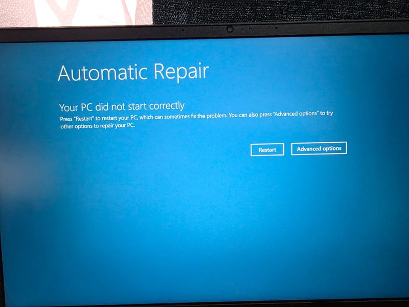

hope that anyone can guide me on the right direction, the laptop "HP VICTUS 15.6 inch Gaming Laptop 15-fb1000 (7Y8M8AV" randomly shuts down and when it boot it shows the blue screen that says AUTOMATIC REPAIR, your PC did not start correctly.
If I go into advanced options and hit restart normally it will boot correctly.
Already did a factory reset and reinstalled the OS, also went to download from the HP Cloud repository the rebuilt image for this equipment and did a full restore, also tried updating the BIOS. and keeps have the same issue
Used the HP diagnostic tool running it on loop and no problem was found on any of the components
