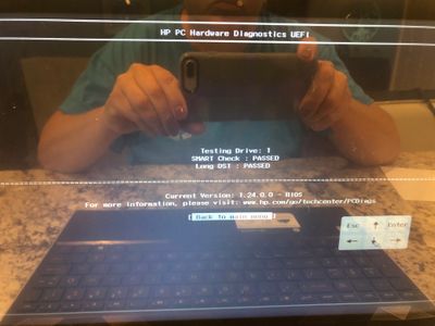

Thank you for your help!  Here’s the screen after doing the Hardware Diagnostics.
how I should I proceed to resolving this boot device error?
