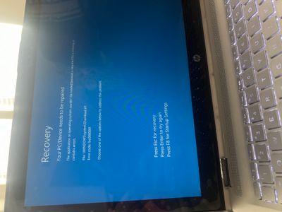

Laptop died a few weeks ago, plugged it back in & the automatic repair loop came up. I have watched multiple videos & followed them but nothing has fixed it yet

 this is what pulls up when i turn it off & back on. F2 still didnt do anything

 i have done some command prompts from watching videos trying to fix it the past few days so idk if thats causing more issues or not. But it wont even do a diagnostic
I don't know why you can't make a diagnosis but everything indicates that your disk is damaged.
Now it keeps turning off on its own every few minutes. Do i get a new disk? Or is there other ways for me to repair this on my own? Or without spending a bunch of money
without doing a test I cannot be sure of your problem, I recommend you first try to reinstall windows from a USB stick.
