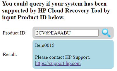

Please provide the Product ID or Model name for better assistance. Preferably the full product ID including the characters after the # symbol. This code may be needed to find cloud recovery files.
Product ID is 2CV69EA#ABU
I tried to see if you have cloud recovery but the site has a problem.
It should tell if you are supported or not.
Try from your location
Go to the below site and enter your product ID including the 3 characters after the # character
If you have cloud recovery you can restore your system using a 32gb flash.
It may take an hour or more to create the recovery USB.
https://d34z73bbtpzgej.cloudfront.net/
I tried the windows store for the cloud recovery and was told the ID did not exist
Call HP and see if you can get a cloud recovery to restore your laptop
