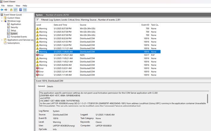

I know how to check the error log on the Event Viewer. The last time it would not turn was May 1st at 11AM here is the Event Viewer from around that time:
Warning 5/1/2025 10:49:19 PM DistributedCOM 10016 None
Warning 5/1/2025 10:47:08 PM DistributedCOM 10016 None
Warning 5/1/2025 10:36:58 PM DistributedCOM 10016 None
Warning 5/1/2025 10:36:56 PM Win32k (Win32k) 701 None

Event Viewer Clues
The DistributedCOM 10016 and Win32k 701 warnings are usually not critical and don’t cause boot issues, especially since they're timestamped before the system powered off (and likely during last use). They don’t suggest a root cause here.

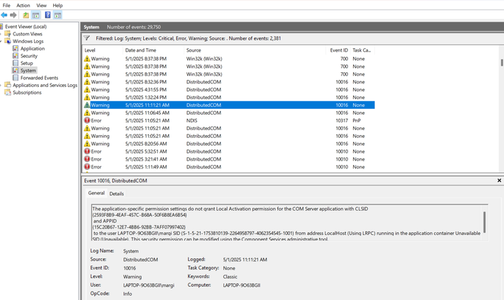

I realized that above I had posted the error messages from 11PM . That was the wrong time. The correct time was 11AM when the computer would not turn on.
Here are the Error Logs from the correct time,11AM
1)
 2)
3)
