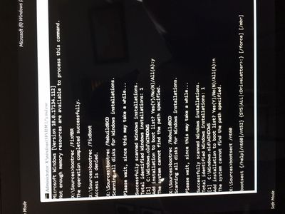

I had a small breakthrough when I downloaded both the 64-bit and 32-bit versions of the Windows 10 iso onto a USB drive.  When I change the boot settings to <Disable> Secure Boot and <Enable> Legacy Support, then change the boot order to read the USB drive first (see picture), I am able to get into the Advanced Boot Options by pressing F8 and can then boot into Safe Mode and get into the Windows Recovery Menu.
However, I have not had success with any of the other options provided to rebuild the boot.  Below are screen shots with the results from the commands you provided.  Sorry, I couldn't rotate the pics.
I also tried all the other options in the Windows Recovery menu without success.
Do you have any other suggestions?  Am I able to format the C: drive and reinstall Windows 10?  Or will that not affect the problems with booting?
Is it worth noting in the first DOS window that I shared that it says "Not enough memory resources are available to process this command."?
Hi
W10 would normally want Secure Boot and a GPT style of formatting.
So if Legacy Boot is having the most effect then stick with that.
Your pictures have yet to be approved.
