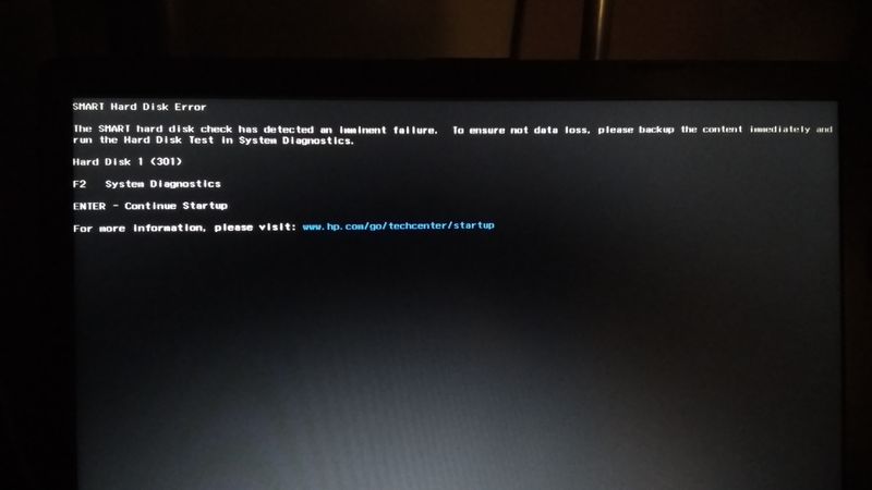

When I switch on my laptop I have the first black screen.
I run the quick hard drive test and I get the second black screen.
Then I press enter and it loads normally the windows. Could you help me with this please?

The error code means your drive is failing. It could crash tomorrow -- it could run OK for weeks -- but there is no way to know and the longer you put off replacing it, the less likely you will be able to recover any data from it. It needs to be replaced.
