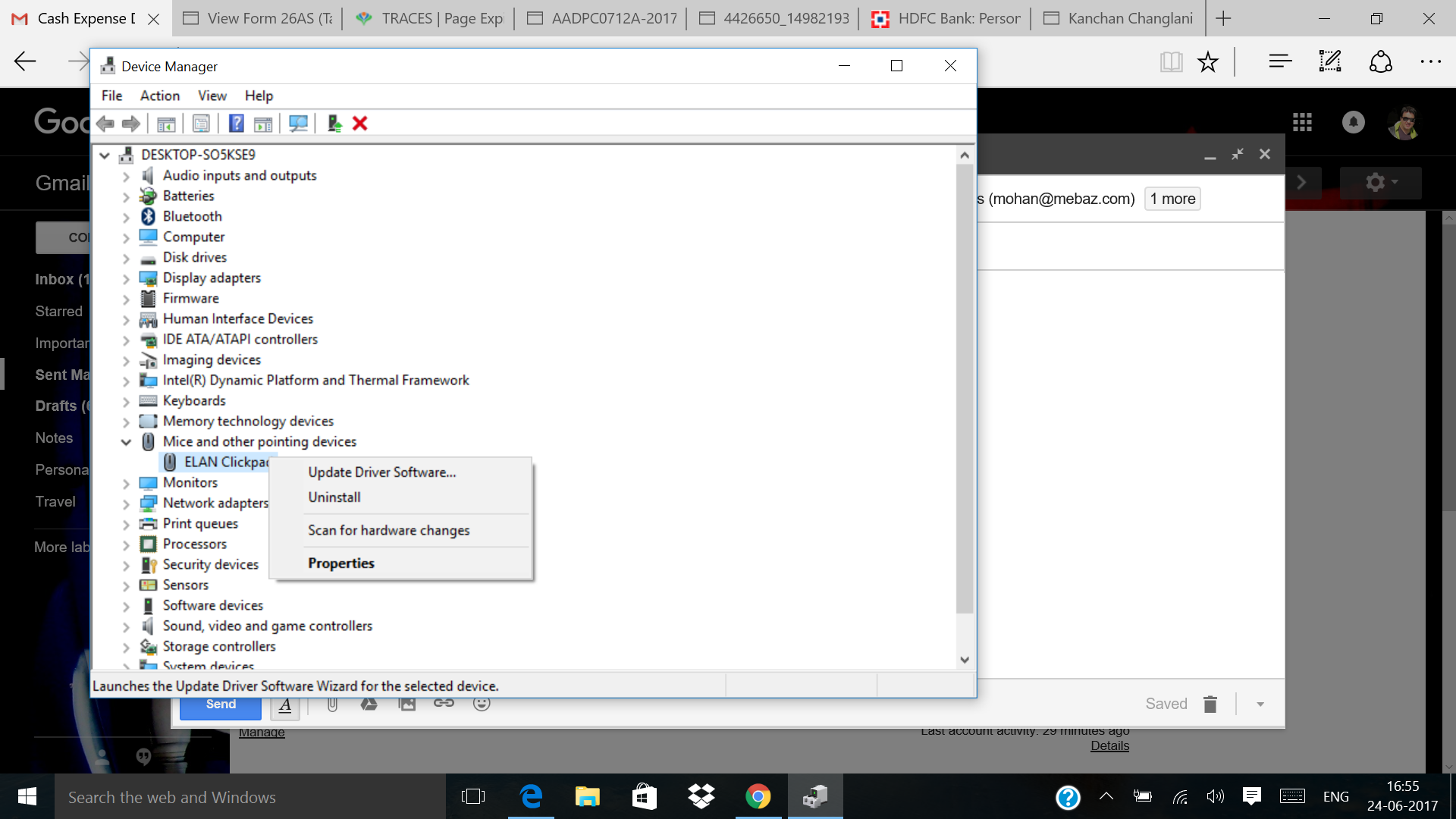

On the HP recommended browser-> 'Microsoft Edge', while writing an email, the cursor cannot be used to "Select" anything nor it can be moved in the middle of my writings?? I double checked-> its working fine on the other browsers and notepad, MS Word etc.  May I know why this issue?? Instead of using the Trackpad *I HAD TO* use the right & left and top & bottom arrow buttons to make any changes or edit my words written.
I also called the HP Technical Support with a case ID: 5001188498 (dated 24/06/2017), but wasn't convinced with the 'ifs' and 'buts' troubleshooting methods which seemed more like a trial & error methods. I am extremely hesitant to 'try out' any such procedures on my brand new HP laptop, which is running fine with my other browsers like Chrome etc. The technical person told me to start with 'uninstalling' the "ELAN Clickpad' from the 'Mice and other Pointer devices' on the Device-Manager (Screenshot attached). But did not give me a 'surety' that the above will work-out certainly. He added that we might have to keep trying out until the 'System Recovery' also or may be further to 'System Restore' etc. which I do not want to try at all. Not very convinced with this. I would need a senior / topmost HP Tech-person, then.
So please help!!
Regards
Praveen Changlani
