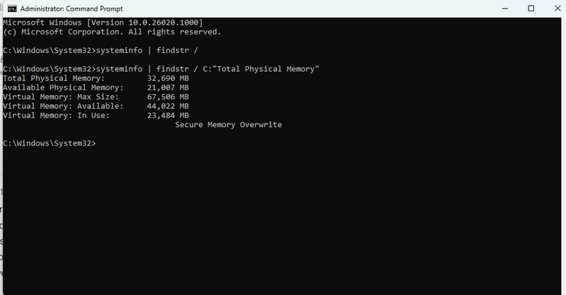

Open an admin level command line window and type the following:
 systeminfo | findstr / C:"Total Physical Memory"
Now press the enter key to see what the OS recognizes as installed and useable memory.
You could also type sys in the search box and click on the system information app that appears above.
That will also show you what the OS recognizes as installed and useable memory.
You should see what is installed, unless you happen to have upgraded the memory with non-compatible memory or mixed memory formats and brands.
OS recognizes 64 GB. I have installed kingston 32*2 4800 MHz

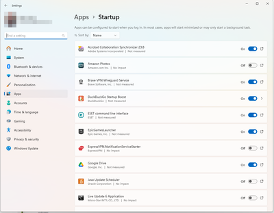

As far as slow startup goes, type startup in the search box and click on the Startup Apps >System Settings that appears above.
The image is from the desktop I am typing this on.  Go through the list on yours to see what is eating up your processor cycles and turn them off to see how it affects your startup time. Doing that will not affect the programs/apps  operation on your PC.
