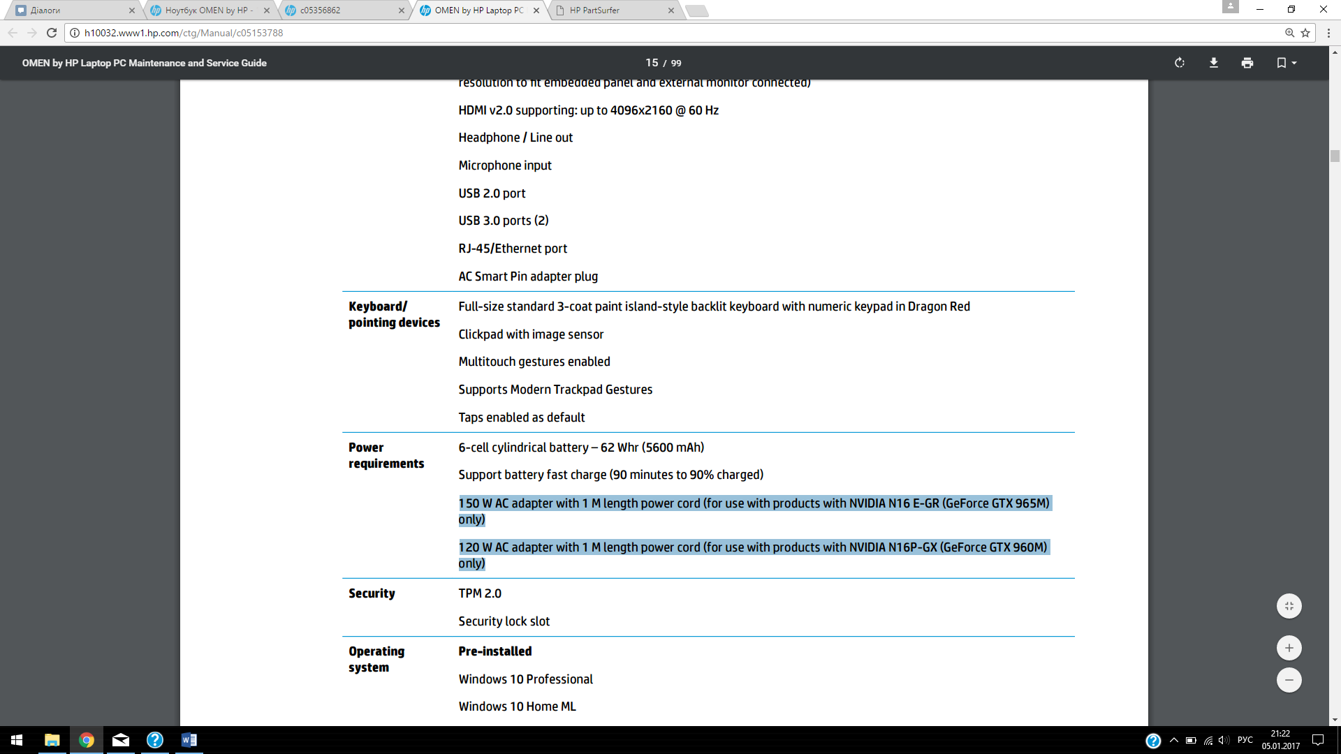

original.pngso as u can see above
the word only is mentioned after each variant
isit on the better side to make the change
what are the chances it may increase my performace
or heat my laptop less?
On this forum it takes a while to see the pictures posted, so I will see later.
The power supply will not make your PC hotter or cooler. When I talk about heat, I am talking about the temperature of the power supply (the ac adapter). There will also be no gain in performance as the 120W is supplying sufficient power to your system.
