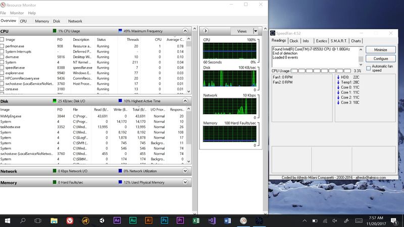

Fans turn on at 75CFans turn on at 75C

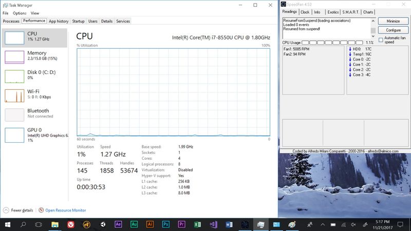

Continuous fan, low tempContinuous fan, low temp
I have posted 2 additional screencaptures to show the 2 types of situations I am experiencing.
  • Fans are off when there is no load, when load drives temperatures above 75C fans spin up to 4Krpm, as temperatures lower the fan will turn off
    • It can take me 20 minutes of restarting to get this experience, it seems to be 100% random
  • The fans turn on over 5Krpm when the computer starts and are never below that speed, regardless of temperature. If the sytem is stressed the fans speed will increase, but when the load decreases the fan speed will only lower to above 5Krpm. Even at 16C the fan is going at a higher speed than the above mode at 78C
    • This is the normal experience I have with this laptop
