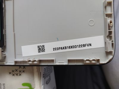

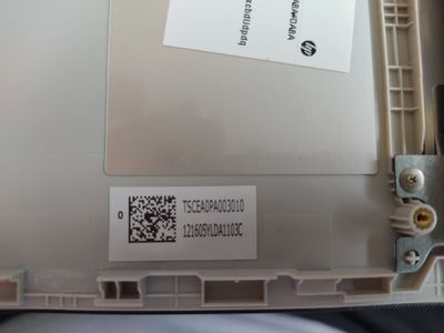

Parts numbers.
More Parts numbers. I did try to google them but no luck.

Unfortunately, since HP did not offer any 2.5" drives in that model series, no part numbers were provided for adding a 2.5" drive.
See chapter 1 of the service manual.  Only M.2 drives were offered.
HP 14-f0000 Laptop PC series Manuals | HP® Customer Support
I checked the manual for the 15-fq model series and HP only offered M.2 drives in that model series as well.
It would be impossible for any of us to determine what drive connector would work.
It is even possible the SATA port is disabled since no 2.5" drives were offered.
