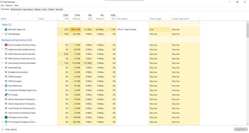

 I have attached a photo of what Task Manager is showing as I write this post (fans are running at high speeds). I do see that power consumption is 'very high' for the GPU, I am not sure if this is normal or if it might be the cause of my issues.

The GPU seems to cause the overheating and fan issue
Try reinstalling the Graphics Drivers from device manager
- Select the Start button, type Device Manager, and select it from the list of results.
- Look for Display Adapters and expand the List
- Look for Graphics driver then right-click it, and select Update Driver.
- Select Search automatically for updated driver software.
- If these steps don't work, try reinstalling the driver: Open Device Manager, right-click the Graphics driver and select Uninstall. Restart your Notebook and Windows will attempt to reinstall the driver.

Thank you for taking the time to reply to me, I really appreciate it. So I reinstalled the graphics driver using the steps you provided, and I had some interesting results. Initially it seemed like my issue was fixed- I had 4 tabs open in my browser and a youtube video playing, the fans didn't kick on, task manager showed the power usage for my GPU was low, and the device wasn't overly warm. However, after about 5 minutes or so, the fans kicked back on and the power usage went to very high again. I replicated this process by repeating the process again (uninstalling the driver and reinstalling it), and the same thing happened. Seems like it could be an issue with the driver itself, but I am not sure. I have attached 2 screenshots here to show you- the first is when it was working, and the second is when it went to 'very high' again.
If you have any other ideas let me know.  If I have to wait for a new driver update I understand. Thanks again.
