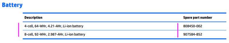

 HP ZBook Studio G4 Mobile Workstation - Maintenance and Service Guide
Part(s) and Replacement procedure >> Page 41
Description                                                                    Spare part number
4-cell, 64-WHr, 4.21-AHr, Li-ion battery
                  808450-002
8-cell, 92-WHr, 2.987-AHr, Li-ion battery
               907584-852

Hello @NAUSHER
See:
See Page 41 Component replacement procedures
Examples:
https://www.hp-battery.com/hp-808450-002.html
https://www.hplaptopbattery.com.sg/hp-808450-002-battery.htm
https://www.hplaptopbattery.co.uk/hp-808450-002-battery-143392.htm
https://www.eetgroup.com/en-ie/808450-002-hp-battery-64whr-421ah-li-ion-wid-w125310523
