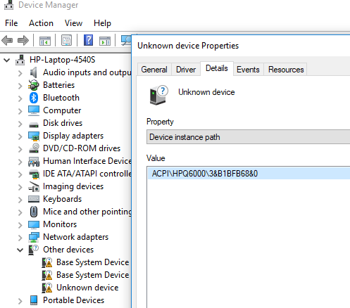

In the Device Manager > HP Laptop 4540S > Other diveces 2 "Base System Device" and "UnKnown" is with "!"

Click on the unknown device with the hardware ID of ACPI\HPQ6000.

I download the sp71714 and the result is shown on photos 1-3
Latest try, I download sp63637 and the 2/3 driver proplems were solved.
The ACPI\HPQ6000\3&B1BFB68&0 is still wiht no driver.
Can you help me pls
As I posted the other day, that device does not have a driver that works on W10 anymore.
You can try this driver, but I doubt it will work.  If it doesn't you will have to do without.
https://ftp.hp.com/pub/softpaq/sp85001-85500/sp85435.exe
