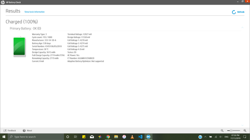

11-19-2019 10:36 PM
Hello, @praveen196 and @olärsonn
I have been testing my battery for 3 days (16th, 17th, 18th Nov 2019) the same way, i.e. through the HP support assistant and for some reason I have gotten better results, around 75% of the original.
I have uploaded the screenshots, for the time and date please check the bottom left corner.
I also tested through HP PC Hardware Diagnostics and it passed.
As of today, the battery capacity is 73% says the test.
PS: I have not updated anything for the past 4 to 5 days. The BIOS was already up to date.
So, should I assume that this was just a software fluke? 1
