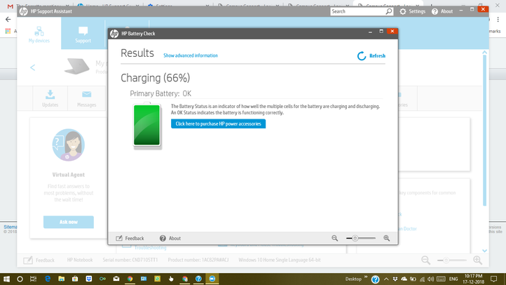

Sir, as requested here is the battery check result :
@DineshRavi,
It is great to have you back and your patience is greatly appreciated.
I recommend you perform a system restore on the computer back to the date when the battery was working fine.
Follow the steps in the below artilce to perform a system restore.
https://support.hp.com/sg-en/document/c03327545
Let me know how it goes and you have a great day!
