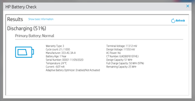

Dear Echo_Lake,
The first time I run 'battery check' and the second time for the calibration, I saw no difference as mentioned in my first email.
However, I did the third check (the attachments) as your suggestion and saw a difference. It shows 97% of Full Capacity. There may be some magic that makes the battery work as normal ^_^.
Anyway, I am so thankful for your willing support!
Regards,
Steve
@Steve3009
Thank you for posting back.
I am glad to know that you managed to resolve the issue. Please reach out again for any further assistance.
