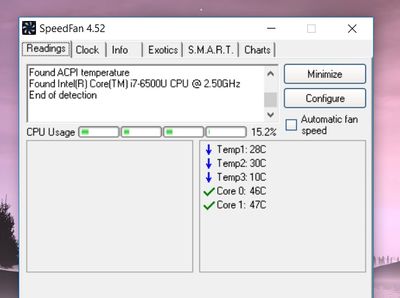

07-28-2017 10:34 AM
No the battery is down lower. That part is directly above the processor. It can get warm. Need to see how warm.
Download Spedfan and run it:
http://filehippo.com/download_speedfan/download/d84fdb3c5e724850f9c7efc78a460161/
Post back results and we can see if the heat is potentially damaging. Above is a speedfan test I just ran on my Spectre 13-v "worlds thinnest".
