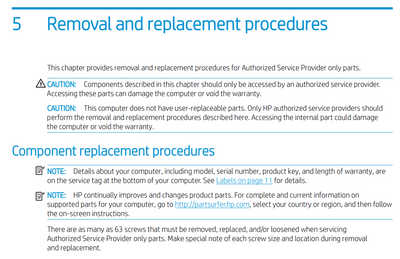

According to your Spectre's Manual: http://h10032.www1.hp.com/ctg/Manual/c06161497.pdf, I must point out that there is a possibility that your laptop may have an alternate battery installed:

However, the aforementioned manual strongly recommends that any repairs/replacements be carried out only by authorized HP service providers -and from my professional point of view, I tend to agree with this assessment given the complexity of your device:
