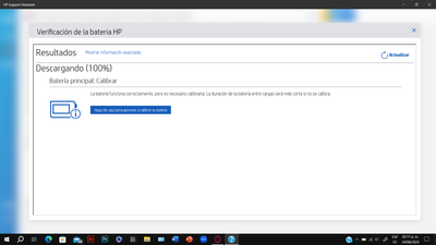

Hello, I changed the battery of my notebook recently and the systems keeps telling me to calibrate the battery but I can't; I've tried discharge it and then charge it again when it's off, I've tried the steps on the hp page, I've tried everything but doesn't work. The battery usually discharges at 80%-85% and then the latop shuts down, I've noticed that the battery a little bit faster, and when I turn it on there's a screen saying "wrong passwotd, write the follwing letters to try again"  or something like that.
I've tried to search a soultion in spanish forums but no advice form there works, so I hope someone here can help me.

Hello, I tried all the things above but nothing has solved the problem. I'm using my laptop plugged all day until the battery stops working to reaplace it. If it works I'll give an update.
