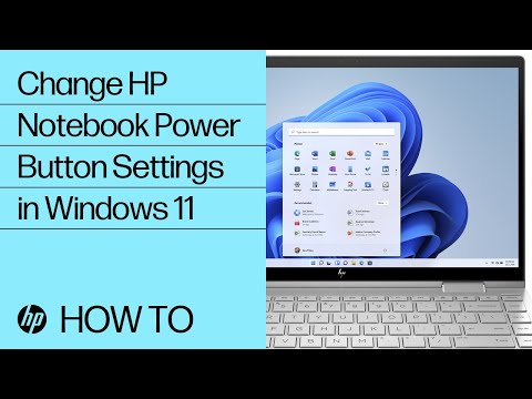

Modern laptops do not actually power off when you press the power button; insted, they go into a hybrid sleep mode -- which continues to use battery power and can generate heat.
To force your laptop to actually power off when you are pressing the power button, watch this video:
https://www.youtube.com/watch?v=GCMgeZ1M7PI
I am a volunteer and I do not work for, nor represent, HP
Learn how to change the Function of the Power Button in Windows 11. There are several different functions that you can assign to the power button of your HP Notebook. This video will explain how to customize the power button based on your preferences. For other helpful videos go to ...
