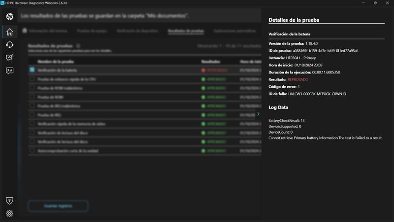

10-02-2024 03:36 PM - edited 10-02-2024 04:23 PM
I have the following error id: UALCW3-000C8K-MFPXGK-C0WN13. What does it mean? Also, the battery charging light keeps blinking in white color. Now it does not even want to turn on
Solved! Go to Solution.
10-03-2024 10:12 AM - edited 10-03-2024 10:17 AM
The error says it is failed.
That means it needs to be replaced with a new one.
