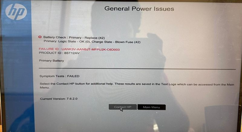

I just ran diagnostic test and just got some error like "Battery check: FUse blown". I am attaching the error image and few error i am facing frequently. Also about the battery purchase link you have given, Is that safe to use that battery as it is suggested to get HP certified batteries, right?

@Avi542,
Yes, unfortunately your battery is toast all right:
You probably cannot purchase a replacement battery via HP:
And the Amazon link I provided should be just fine -most of us purchase replacement batteries for our laptops this way.
