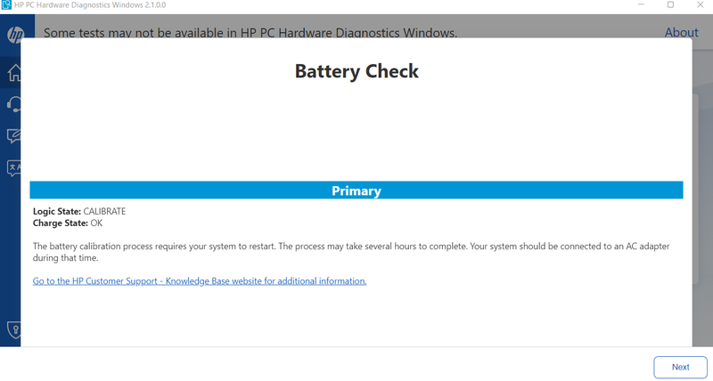

I 5 days ago i  got a new battery and have been having trouble calibrating it, it randomly goes off without warning even though not drained. I have taken the necessary steps finally even removing and placing the battery back but still nothing, this is the message I keep getting on the pc hardware diagnostics
Kindly help, should i replace the battery?

See this HP web document
https://support.hp.com/us-en/document/ish_2268927-1713329-16
If that does not help
Here is a link to a Windows enthusiast forum with great information on how to calibrate your Laptop's battery.
https://www.windowscentral.com/how-calibrate-battery-your-windows-10-laptop
If calibrating the battery does not resolve the issue, I do suggest replacing the main battery.
Calibration is actually calibrating the former 100%  full charge to the current full charge storage capacity, not the capacity of the battery when new, since the storage capacity of a battery does diminish over time.
