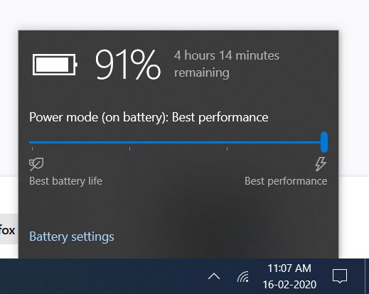

I've lot of problems with the battery of my notebook.
Sometimes it shows error 601... battery too low... at startup
  - after entering get at least one hour working with '0% battery'
  - after 1 - 2 hours it will show ... 'battery too low'.
  - when ac code connects shows ... '0% not charging' and works fine.
  - In 2 hours battery indicator will show ... '100% not charging'
Sometimes no problem, boots without any battery message and works fine for 3-4 hours
Now the real problem is can't check the battery in HP PC Hardware diagnostics or HP Support Assistant.
Always cancels automatically.
Below is the screenshots
Is there any solution to..
 1. solve error 601 - tried uninstalling Microsoft ACPI-Compliant Control Method Battery, battery disconnect etc.. etc...
 2. solve battery check problem

Thank for the suggestion...
But no cure.
Step 5 in the list not appears in this system. When I click uninstall in ... Method Battery", it just disappears, no prompt to remove the current driver.
After refresh, again this appears in the "Batteries".
Is there any other way to remove the battery driver and reinstall.
Can I delete the files from system32/drivers.
and the problem is still on.
In one or two day once the notebook seems OK. works in battery for 3-4 hours. When charger connects problem starts.
Now, I'm working in the same system for half an hour on battery.
Battery showed low at startup and on windows start message also.
and the battery button shows, still not connected AC power, works good.
Will you please suggest anything to solve this.
I can't trust the PC in the case of battery.
I think a battery change will not help.
Thank you again.
