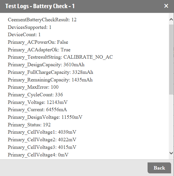

I have a HP Pavilion 14-al062nr and i am facing issue that my battery won't exceed charging above a certain percentage. At the begining it was not exceeding 36% then it is at 43% and won't increase the percentage regardless of how long i keep the charger plugged in. I have win 10 64 bit pro and it shows 43% available (plugged in, charging).
Upon running the hp support assistant's battery check it says that i need to calibrate the battery but it is not giving any option to do so and instead provide me with manual instruction but the main problem is that the instruction says that i have to charge the battery up to 100% in order to calibrate but as i stated above, i am unable to charge it above 43%.

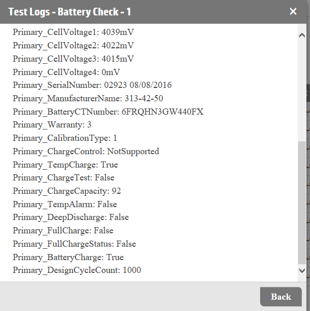

  • tried running the hp pc hardware diagnostics UEFI but it instead shows that Battery status: OK. i think that it is not checking the battery correctly because the desktop program when tried to run the battery check, stucks at 10% for a moment and then abruptly shows that test CANCELLED without showing any results.

HP PC Hardware Diagnostics Battery check log (1)HP PC Hardware Diagnostics Battery check log (1)HP PC Hardware Diagnostics Battery check log (2)HP PC Hardware Diagnostics Battery check log (2)HP PC Hardware Diagnostics power check cancelling on its ownHP PC Hardware Diagnostics power check cancelling on its own

Replace the battery.
HP part number   849908-850
Your manual here.
http://h10032.www1.hp.com/ctg/Manual/c05122703
Your battery has 4 cells.
If you look at your tests one cell is dead.
Your manual here.
