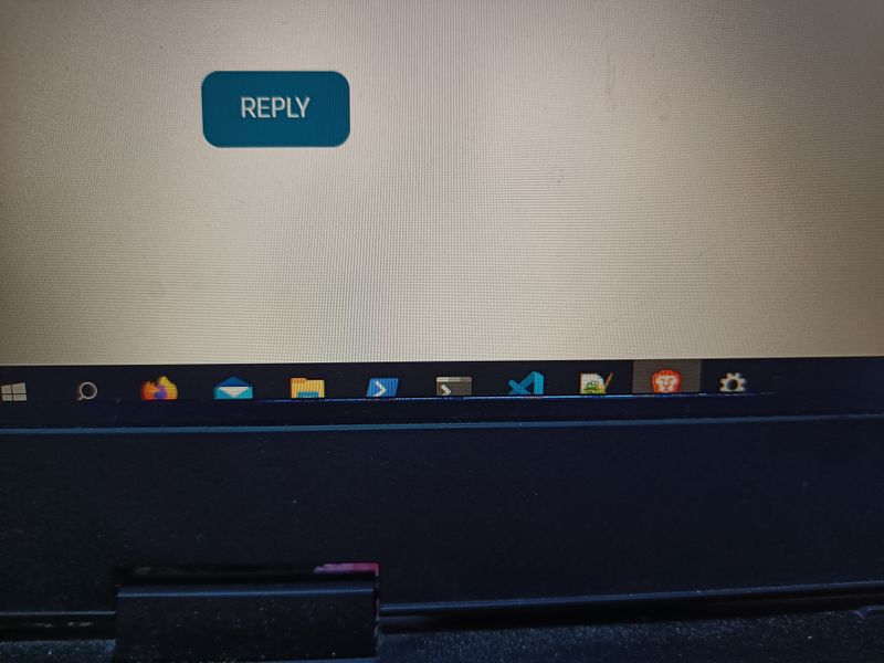

Hi!
I recently noticed a screen wide black thick line appearing on my screen which seems flickering.
But, when I switch from 60 Hz to 30 Hz, the dead screen seems to come alive with a white flickering line over it.
What could be the issue here?

I connected an external monitor which seems to work fine. However, the dead screen on my laptop screen keeps getting worse. Could you please give more technical detail of this failure.
Also, the failure persists even at BIOS.
Thanks.
