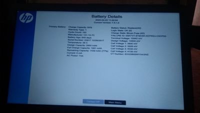

My laptop battery notification light colour changes orange and white simultaneously while charging and my laptop shutdown while it has 30-50% charge.I ran the components test and got the battery check results ok sometime and sometimes as blow fuse(42).How to resolve this issue?
1 REPLY 1
To resolve the issue you will need to replace the main battery. The diagnostic image #2 you posted also states that. It also lists the battery as a failed component.
