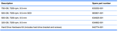

If you are not under warranty, you will need to replace the hard drive yourself or bring the computer to your local computer repair shop. Make sure you have gone through mdklassen's post on backing up your files. Steps to replacement are located on pages 75-76 on your computer's Maintenance and Service Guide.
If you wish to, you can order the hard drives that are 100% confirmed to work with this model, from HP:
You can then use the HP Spare part number(s) in the HP Parts store hereYou may also be able to find it elsewhere on the Internet.
