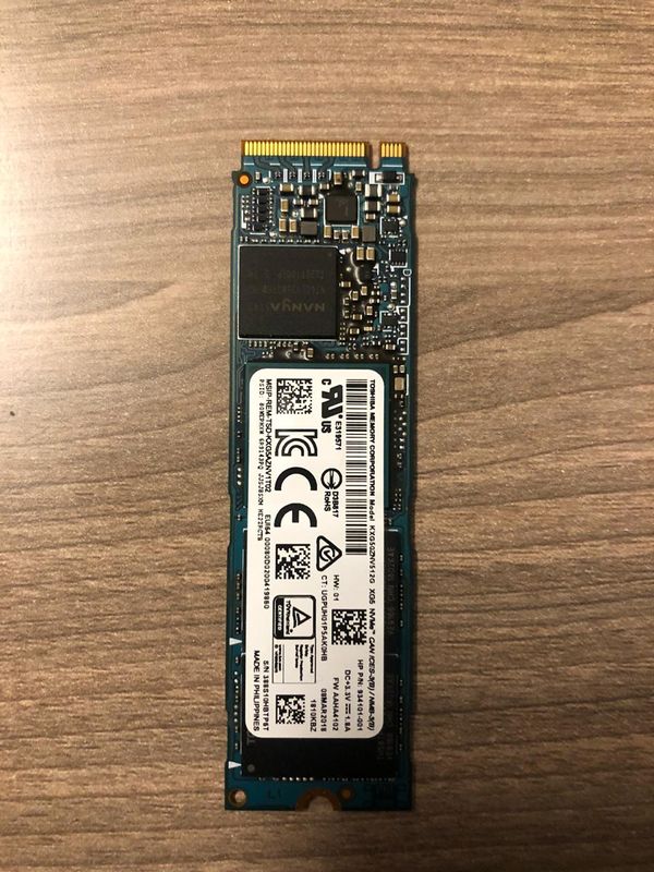

- How can I check authenticity of the solid hard drive? It reads TOSHIBA MEMORY CORPORATION...
- I need to know how to find out whether the solid drive (memory card) was used on another machine (I have suspicions that the person who tried to repair could steal my personal information. Is it possible to check whether somebody actually plugged my solid drive into another device to read it?

I am attaching the pictures of the motherboard so you can show me where the microcontroller is, if you would be so kind, of course. I also wanna make sure if it is really burnt (the laptop does not work at all). Also, here are pictures of my SSD card. I am pretty sure it's original and it was not substituted. However, it is very much important for me to know if the technician opened it on another device and copied the files. Obviously, he did not have to do it, I only asked them to pin point the issue and they had absolutely nothing to do with my SSD. Earlier you mentioned that a forensic examiner could tell if it was accessed while in the custody of a technician and likely what was done and if files were copied. Is there any way for me as the owner of this laptop and the SSD to get this information (even if it's gonna be expensive)? I cannot find a forensic examiner here, seems impossible. However, I will definitely buy that SSD adapter from Amazon to restore my data before I manage to repair my laptop.

That is definitely an HP M.2 SSD. See the "HP Part number" on the label? You really need a magnifier to examine the motherboard but I see no burnt capacitors. When they burn it is often the ones closest to the power jack. I really have no way to tell you haw to find a forensic examiner in your country. You could use that adapter and a disk cloning app and make a forensic image of the drive contents and an examiner from anywhere in the world could examine that if you post it to dropbox or something like that.
