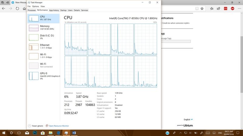

It has only been two months since i bought this laptop and the cpu tempratures are constantly at 85 to 95 degrees celcius even when i a m just surfing the web an doing some work on microsoft word. When i open the task manager i see that my cpu clock is at 3.8 GHz mostly even with the utilization of 5%. Untitled2.jpg

I understand that you have and HP Spectre x360 - 13-ae087tu and the CPU overheats. I read that the CPU clock is at 3.8 GHz mostly even with the utilization of 5%. Not to worry, I'll be glad to assist you with this case.
