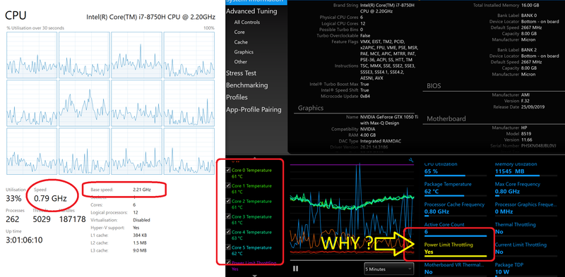

Here is a screenshot of my computer supposedly running on best performance ... all I did was refresh a YouTube page running in Google Chrome... the HP thermal profile is set to "Performance"... the processor was already below 2.2Ghz before I hit refresh - the moment it started to refresh... wham... the CPU frequency plummets further while the page is (slowly) re-loading ... it's several years ago since 0.79GHz was considered a 'high performance' CPU!

In the Intel XTU - screenshot above - it reports the BIOS is manufactured by AMI.... do HP even have any control of this, or are they reliant on AMI to investigate and fix BIOS issues? Are HP just treading water and playing for time, hoping with fingers crossed that AMI happen to release a new BIOS? Or are HP actively working with AMI on this?

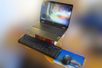

This is how I always intended to use it for productive work when I chose a 2-in-1 PC  ... when reading reviews slating it for being too heavy for a 2-in-1, I generally ignored that criticism of it, because I never intended to use the 2-in-1 feature for a tablet; I always intended it for the following setup...
And this worked fine at high performance with the original F28 BIOS.
I think it speaks volumes that even though I hide the computer away every day when I go out (so I'm always putting it back in its case, and setting it back up again daily), for the past 3 months the thought didn't even cross my mind to try it in a different position to the above when setting it back up on the desk. Why would I, when it worked at high performance in that position when I first received it?
Now with BIOS F32, there isn't the option to push the built in keyboard out of the way and still get high performance. For high performance, I'm going to have to be using it like this.... which isn't satisfactory.
