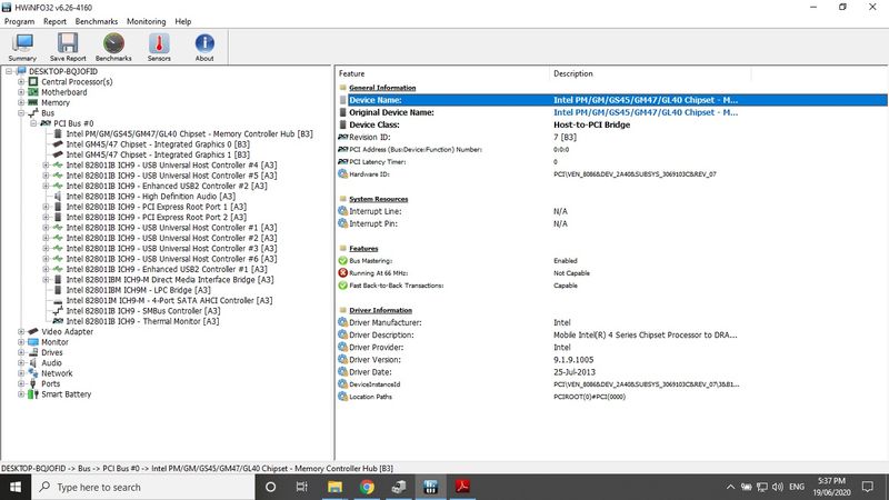

If you don't know what chipset your notebook has, I have zipped up and attached a free utility below, that will provide that information.
See screenshot above, which chipset is it and how far can I go... corei3? quad-core processor?
It appears your notebook has the Intel 45 chipset.  I usually look at the summary window that first opens to find it.
The best you can do is the P8700.
No intel core processors will work in your PC.
