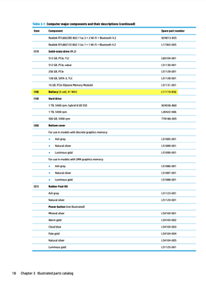

The link that @banhien provided does work. I just checked it. This is an assist, not a solution.
https://store.emprgroup.com.au/p-566954-m01144-005-sko-batt-3c-43wh-375ah-li-pp03043xl-pl.aspx
Original HP 3 Cell Battery, 43Wh, 3.75Ah, Li-ion, PP03043XL-PL [PP03XL]
The Maintenance & Service guide for your laptop's model series
https://h10032.www1.hp.com/ctg/Manual/c06523509.pdf
Battery (3-cell, 41 Whr)             L11119-856
