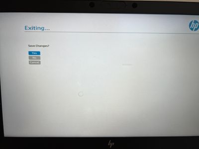

Hello @Lilian38
(1) Disable <Secure Boot>, save settings and exit
(2) Send picture of BIOS <change request> (4 digit code) <- random code, no sensitive data !
Kind regards
First, I change from the state <Legacy Support Disable and Secure Boot Enable> to <Legacy Support Disable and Secure Boot Disable>.
Then I save.
And there is the change request (I just type the 4 digit code and press enter).
 After that, the computer reboot and Secure boot is back ! :[
