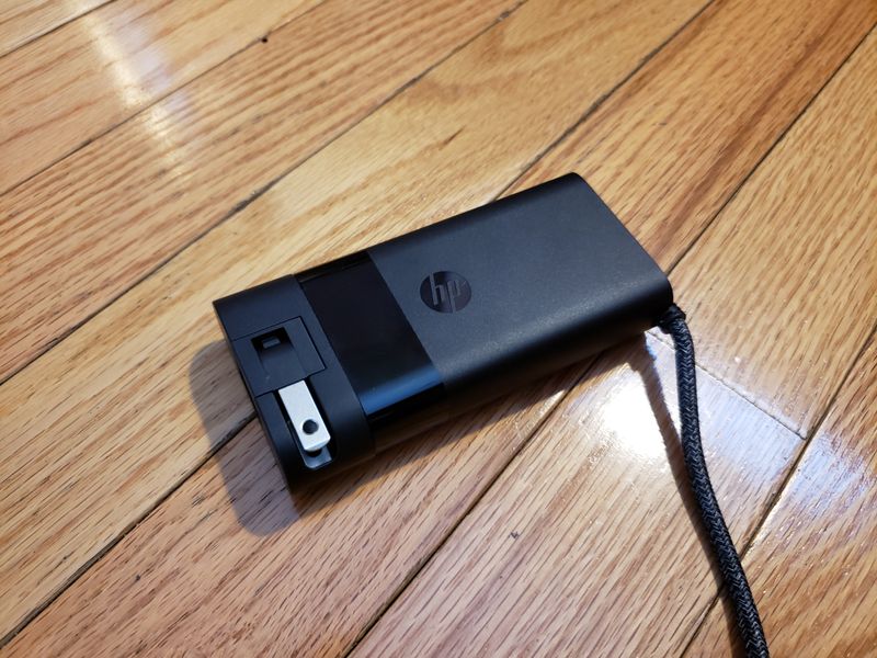

I will have to take a look at those, thanks for the response. As a note, I have tried out the two items listed above to make the included charger more portable.
First up, the NEMA to 3-prong US plug. This, as expected, works perfectly.
Though, it is not the best looking option.
The XPS13 adapter is near perfect. However, I had to use a drill bit and a file to "cut out" between the two top circles so it could attach to the HP brick perfectly. There is a notch, but it's not standard NEMA, it's a square notch instead of curved. This was very easy to do, and could be done with just a file. Once installed, it is near the perfect size, and the fold out 2-prong adapater is perfect. This is what I'm using going forward for now.
