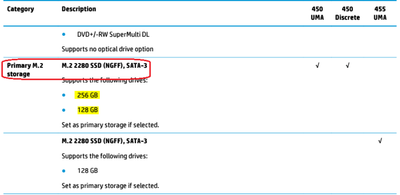

Thanks a lot @NonSequitur777 for the quick response. Just one more small question. What does this section mean exactly? Does it mean that the notebook will support upto 500GB SATA SSD and 256 M.2 2280 SSD only? The reason I am asking is because the notebook originally came with a 1 TB Toshiba MQ01ABD100 storage preinstalled and this 500 GB description text is actually confusing.

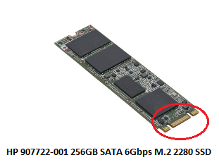

Instead of Crucial P2 500GB 3D NAND NVMe PCIe M.2 SSD, I ordered the SAMSUNG 980 SSD 500GB PCle 3.0x4, NVMe M.2 2280 from Amazon but it just won't fit. I took a pic of the motherboard SSD slot for the notch and it looks like ideally it should but it wont go through and I am afraid I might break the SSD if I apply too much pressure to push it in. Apart from this problem, Samsung didn't even provide a screw to bolt it in (if it actually went in).
The Corsair and Samsung SSD notches are also added for your reference.
You had earlier shared this particular SSD image but there are 2 notches here compared to 1 on motherboard. Will this fit G4 notebook instead?
07-20-2022 09:49 AM - edited 07-20-2022 09:50 AM
According to your notebook specs, your notebook is fitted with an M.2 (NGFF) 2280 SSD slot, not an M.2 NVMe SSD slot as I illustrated earlier:

07-20-2022 11:28 AM
Thanks again for the quick response. Guess I will return the NVMe SSD and get a NGFF one, but looking at the pic shared, will the notebook really support 512 GB NGFF SSD? Because the screenshot shared shows that only 256 GB/128 GB are supported but no mention of a 512 GB SSD. Just want to double check and not mess up again.
07-20-2022 12:29 PM
Excellent question: the answer is that your M.2 NGFF 2280 SSD slot can handle at least 500 GB: searching through UserBenchMark HP ProBook 450 G4 Users here: https://www.userbenchmark.com/UserRun/38209365, I found several notebooks fitted with a Samsung 850 EVO M.2 500 GB and a Crucial CT500MX500SSD4 M.2 500 GB SSD.
Since the 500 GB apparently works just fine, there is no reason to believe a 1TB M.2 NGFF 2280 SSD wouldn't be compatible.
