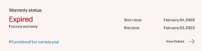

I purchased an HP Pavilion Gaming Laptop 15-ec2xxx on 23/03/22 with an extended warranty of 3 years (Platinum Plan) from an offline store (CROMA) but it still shows expired on the website.
