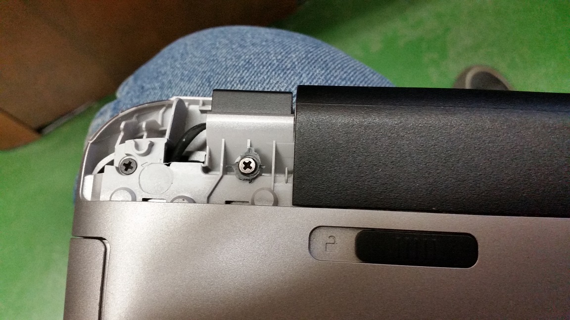

Hi there! I am using this Envy 15T for a about a year-and-a-half. The corner of the bettery holder (I don't know what you call it...I can upload a photo if that is possible) has broken off, which makes the battery rather loose. I wanted to know if you sell this as an accessory, or if there is a way to fix this.

The battery board is a separate replaceable part on some laptops but would require extensive disassembly to replace. But I think that may not even be what you are talking about. A picture and the full laptop model number would help us give a definitive answer but don't hold you breath for this to be an easy or inexpensive repair.

I could not upload the picture here because it says file size is too big. Is there some other way that I could send you the pictures?

Ah ok. Found a way to reduce the file size. Here they are
From what I can guess by reading some of the stuff previously posted, I probably need a new hinge cover. Does HP sell that part for Envy 15T?
Yes they are called "base enclosure caps" and they are shown on page 46 of the Manual here:
Manual
Base enclosure caps (Included in the plastics kit)  For HP ENVY 15 Notebook PC computer models 763787-001
